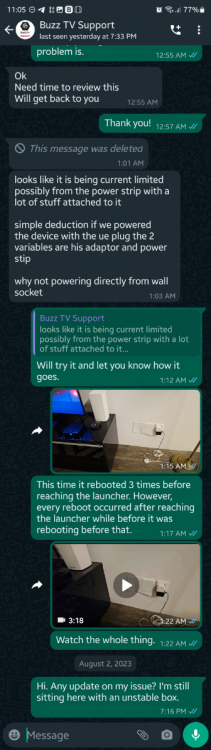

Saif Barry Posted August 26, 2023 Author Share Posted August 26, 2023 (edited) @Tlr Yeah, my box does the fast stutter and reboots too. Unfortunately I don't have anything positive to report on this. I still have what seems to be a defective box and zero support from BuzzTV. I was able to get through to support on WhatsApp. After a lot of troubleshooting, changing of power supplies, power outlets and sharing of video recordings of the problem, I was told they need time to review and would get back to me. That was on July 25. I followed up on August 2 and my message was read but was not responded to. My original ticket #20217 from 11 July is still open and unresolved. At this point I've accepted my losses and given up on expectations of any kind of customer support. Lesson learned, don't buy BuzzTV. Edited August 26, 2023 by Saif Barry Formatting Quote Link to comment Share on other sites More sharing options...

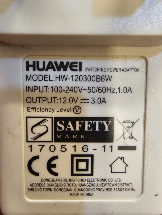

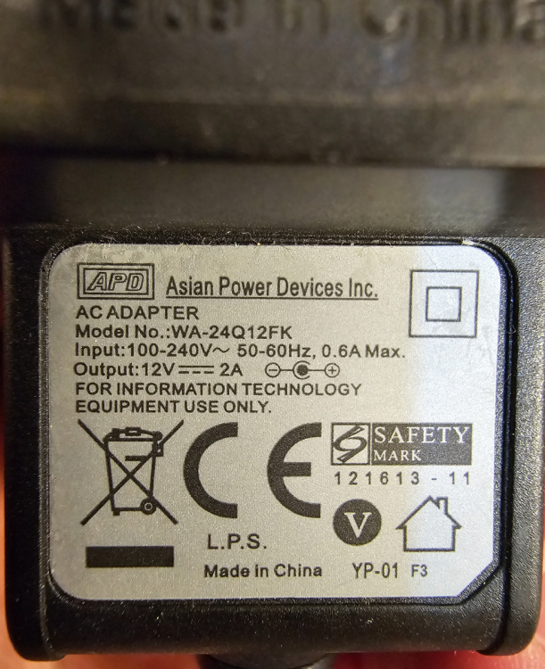

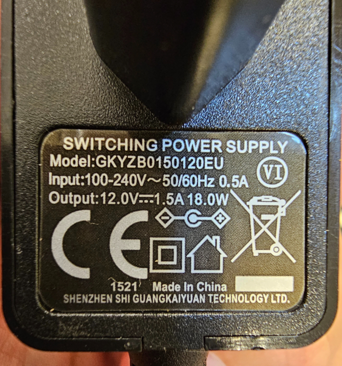

Saif Barry Posted August 26, 2023 Author Share Posted August 26, 2023 12 minutes ago, dishuser said: are you using the 12 volt power supply? Yes I am. I have tested the box with 3 different 12v power supplies with no change in behavior. Quote Link to comment Share on other sites More sharing options...

allaboutbuzz Posted August 26, 2023 Share Posted August 26, 2023 3 hours ago, Saif Barry said: Only the first power supply is the one that came with the box The other 2 will not power the U5 properly. 1 Quote Link to comment Share on other sites More sharing options...
Saif Barry Posted August 27, 2023 Author Share Posted August 27, 2023 4 hours ago, allaboutbuzz said: Only the first power supply is the one that came with the box The other 2 will not power the U5 properly. At present neither one does. Quote Link to comment Share on other sites More sharing options...

Saif Barry Posted August 27, 2023 Author Share Posted August 27, 2023 33 minutes ago, nbs. said: Have you ever tried the buzz power adapter for your country? The 3 power adapters are the only ones I have tried. One of them is what I got from buzz which is the EU version rated for 100v to 240v and 50-60Hz. I'm in Saudi Arabia where the standard is 230v and 60Hz. The electrical system in Saudi claims to follow the UK standard which is 230v and 50Hz. As far as I know, the EU and UK power adapter is the same except for the plug on it. If this is not true please correct me. Quote Link to comment Share on other sites More sharing options...

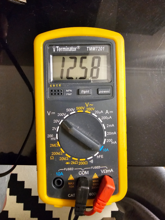

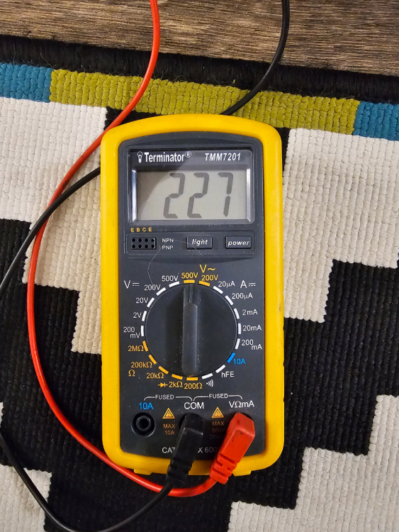

Saif Barry Posted August 27, 2023 Author Share Posted August 27, 2023 2 minutes ago, Ryu said: do you have outlet tester? just to see if your power outlet (from wall) is correct? also, its possible for you to test this unit on different tv? I have a voltage tester if that's what you mean. I'll check the voltage and report back. I will also check the U5 on another TV and room altogether. 1 Quote Link to comment Share on other sites More sharing options...
Ryu Posted August 27, 2023 Share Posted August 27, 2023 (edited) you can use voltage tester to test power supply and make sure you are getting correct power from power supply and not sure if your voltage tester all functions but this is what im talking about. Edited August 27, 2023 by Ryu Quote Link to comment Share on other sites More sharing options...
Saif Barry Posted August 27, 2023 Author Share Posted August 27, 2023 33 minutes ago, Ryu said: you can use voltage tester to test power supply and make sure you are getting correct power from power supply and not sure if your voltage tester all functions but this is what im talking about. No, I don't have anything like that on hand. However I would suspect if the electrical system at my place was improper I would see other devices malfunctioning or getting damaged. Apart from the typical household appliances, I have the usual battery of electronics at my place, a router, a modem, several wifi access points, PCs, laptops, TVs, TV boxes etc. Never had a problem with anything. The U5 is the only thing misbehaving. I was able to test the voltage on the outlets and the power supply, both of which check out. 227v and 12.58v respectively. I also tested the U5 with a different TV, in another room using a different outlet, (replacing a working 12v Android box) with no change in behavior. Still goes into a bootloop. Actually the U5 doesn't even have to be connected to a TV, you can tell it's in a bootloop looking at the indicator light on the front. Goes red after after 30 or so seconds. It does eventually boots to the launcher but then will reboot again after a random period of time. 1 Quote Link to comment Share on other sites More sharing options...
