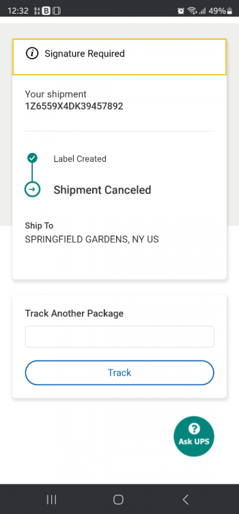

Saif Barry Posted September 2, 2023 Author Posted September 2, 2023 (edited) @allaboutbuzz power supply shipment canceled. Not sure why, trying to follow up with support to find out what happened. Edited September 2, 2023 by Saif Barry Quote
