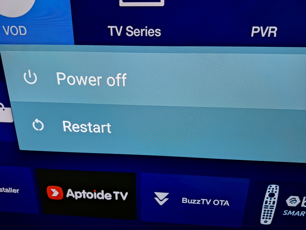

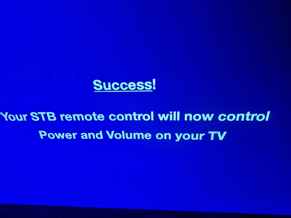

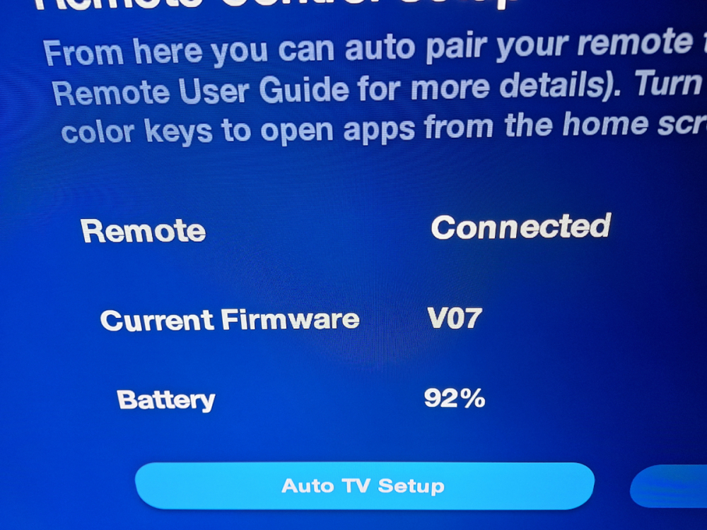

ismael Posted March 1, 2024 Posted March 1, 2024 After launching Auto TV setup and configure the sound option you can not shutdown/reboot the box anymore with the power button of the remote. Because the power button of the remote shut down the TV and not the box (after launching the Auto TV setup, before all works fine). The HDMI-CEC from TV send the shutdown signal to the box. To be able to shutdown/reboot the box, the power button of the remote should send the shutdown signal to the box and the box should send the HDMI-CEC shutdown signal to the TV. Now I use the HDMI-CEC option on, without the Auto TV setup, all works fine, except I can not control the TV volume with the box remote. Is there an solution ? Or we should wait fix in next update ? Quote

ismael Posted March 1, 2024 Author Posted March 1, 2024 15 minutes ago, dishuser said: my bt 400 controls the tv volume but not the box I can reverse that so it controls box volume but not tv volume Thank you for you answer, I know this and I make it works also. My question is : How to have restart/power off menu with HDMI-CEC enabled AND Auto TV setup configured (with my TV brand) ? Because F brand have this feature, which is really good. And if they implemented this feature it's because it's very practical. Again I don't critize buzztv box I only want the buzztv boxes have this good feature. Which is really useful. I project to buy P6, U5 was only a test before P6. But this features should be implemented, because it is very useful and practical. It's the details that make the difference Quote

ismael Posted March 1, 2024 Author Posted March 1, 2024 10 minutes ago, dishuser said: my power button turns tv/box on or off at same time sounds like you don't have cec configured properly What I mean it's to have the menu Power off / Restart Yes the power button puts the TV and the box in standby. So HDMI-CEC it's properly configured. But if I want to unplug my box from power outlet, I should first Power off, not put the box in standby But when HDMI-CEC is enabled AND Auto TV setup configured it's not possible to acces to the menu Power off / Restart. Only standby When HDMI-CEC is enabled AND Auto TV setup NOT configured I have three choices for my box : Standby (with power button) and Power off / Restart with the menu When HDMI-CEC is enabled AND Auto TV setup configured I have one choice for my box : Standby (with power button). Power off/Restart menu (long pressing power button does not display anymore Power off/Restar menu, puts everything in standby). It would be really nice to have HDMI-CEC enabled AND Auto TV setup configured AND long pressing power button makes the Power off/Restart menu appears Quote

ismael Posted March 1, 2024 Author Posted March 1, 2024 3 minutes ago, nbs. said: If you hold power button down what options come up? It puts the TV and the U5 in Standby (HDMI-CEC is enabled AND Auto TV setup configured). No more menu with Power off / Restard options Quote

ismael Posted March 1, 2024 Author Posted March 1, 2024 12 minutes ago, nbs. said: When I hold power button down nothing happens until I select an option the same here until I set up Auto TV setup (which allow me to control the volume +- of the TV, with the BT-400). When Auto TV setup is configured holding power button puts the box and the TV in standby without any menu choice Quote

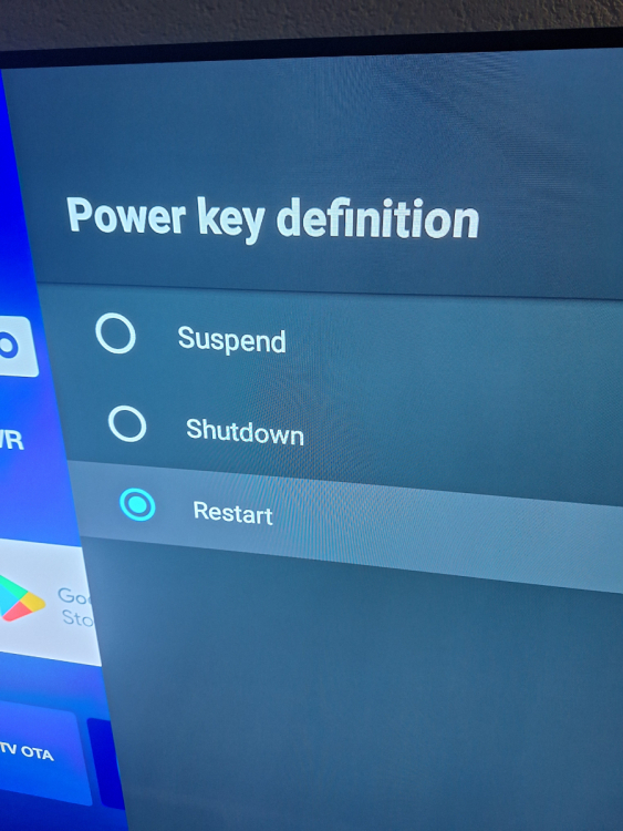

ismael Posted March 1, 2024 Author Posted March 1, 2024 11 minutes ago, dishuser said: change powerkey option it does not work, it puts the TV in standby mode and nothing happens to U5 box. And even if it's works it's not a good option. Imagine, I reboot my box but my TV is in standby mode, and I should power up again my TV. The mistake and the Auto TV setup is "will control Power" Auto TV setup should only control the Volume of TV not the power (standby). HDMI-CEC it's here to control the power off ot TV. I am really the only one I see it's an non sense ? I don't think I am so stupid and crazy, because on all other boxes the equivalent of Auto TV setup does not control the Power of TV only volume. Quote
allaboutbuzz Posted March 1, 2024 Posted March 1, 2024 50 minutes ago, ismael said: It puts the TV and the U5 in Standby (HDMI-CEC is enabled AND Auto TV setup configured). No more menu with Power off / Restard options This is because it changes the power button and vol buttons to IR to control the TV directly Not the box. And since we only have one power button on the remote. That's how it works We have a new remote coming out. The BT500. Which resolves both issues as it will have 2 Power buttons (TV + STB) and 2 Vol +/- buttons ( TV + STB) 1 Quote
allaboutbuzz Posted March 1, 2024 Posted March 1, 2024 6 minutes ago, ismael said: it does not work, it puts the TV in standby mode and nothing happens to U5 box. And even if it's works it's not a good option. Imagine, I reboot my box but my TV is in standby mode, and I should power up again my TV. The mistake and the Auto TV setup is "will control Power" Auto TV setup should only control the Volume of TV not the power (standby). HDMI-CEC it's here to control the power off ot TV. I am really the only one I see it's an non sense ? I don't think I am so stupid and crazy, because on all other boxes the equivalent of Auto TV setup does not control the Power of TV only volume. We have been selling 3 models with the BT400 Remote and Smart Set feature now for 2 years You're the first person to bring this up to be honest. We haven't had anyone else make comments about how the Power + Volume buttons work for Auto TV/Smart Set feature. And our remote is made by the same factory that makes for Google. Even Google Chromecast is setup this way. As I just tried it. 2 Quote
