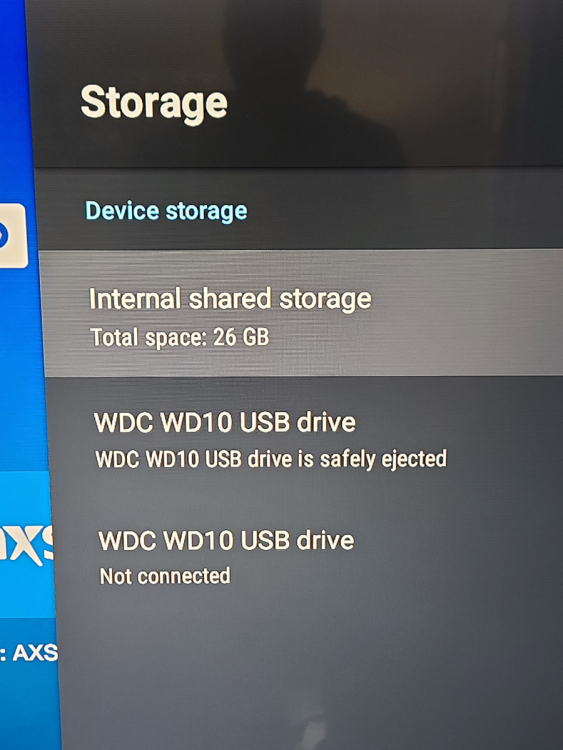

gherna1 Posted December 31, 2022 Share Posted December 31, 2022 Hi. Thank you for the feedback. I have done so to no avail. I’ve replaced the HDD with another HDD to discard the possibility of a defective HDD. NOT! Weird thing is, once I formatted the new drive (multiple times), I could not transfer data to it. After that, a new “Android” drive shows under “Storage”, and after several attempts to do so, I now see several identical HDDs listed, besides the original one, but all say “Disconnected”. What gives? I think the BIOS needs rework. This is so disappointing! Quote Link to comment Share on other sites More sharing options...

gherna1 Posted December 31, 2022 Share Posted December 31, 2022 Hi. I formatted the new drive using the same default option for storage and something else (I forget the wording). Next, I tried storing my device data (apps and stuff) on it and this is where it supposedly failed, prompting me to repeat the procedure, only to discover that the drive still does not work and now I see it listed multiple times without an option to remove or “connect” a disconnected drive. On the repeat occasions the formatting appeared to be functioning (progress bar) but others it would simply and immediately display a message saying “formatting completed”. At this point I simply gave up and have ordered a 1TB SSD to try with. The two drives are WD HDDs, 1TB capacity; one the original that came with the “Launch” promo and the other I had laying around from another PC. Quote Link to comment Share on other sites More sharing options...
dishuser Posted December 31, 2022 Share Posted December 31, 2022 format as removable storage 1 Quote Link to comment Share on other sites More sharing options...
gherna1 Posted December 31, 2022 Share Posted December 31, 2022 That’s what I selected, now that I see the wording. Thank you! Quote Link to comment Share on other sites More sharing options...
dishuser Posted January 1, 2023 Share Posted January 1, 2023 (edited) eject the drive unplug and plug back in and format as removable drive don't forget to go into pvr options and select that drive for what you want mine is listed as android in both my u5 and 4900 Edited January 1, 2023 by dishuser Quote Link to comment Share on other sites More sharing options...
Emporium Posted January 1, 2023 Share Posted January 1, 2023 As DU mentioned, if you have an option, you NEED to ensure it is formatted as Portable Storage and NOT Internal Storage. Quote Link to comment Share on other sites More sharing options...
gherna1 Posted January 1, 2023 Share Posted January 1, 2023 Thank you for the feedback. I’ve done the first several times when it’s detected. The other times I can only see its status. I’ve disconnected the device, turned power off and restarted it. Sometimes I would see the message about the HDD being attached, but only 2 out of 10 times. The other times I only see messages about TS not syncing when I switch channels. I’ve given up. I believe it’s a poorly written BIOS that fails to detect the hardware and only does it haphazardly. Quote Link to comment Share on other sites More sharing options...
