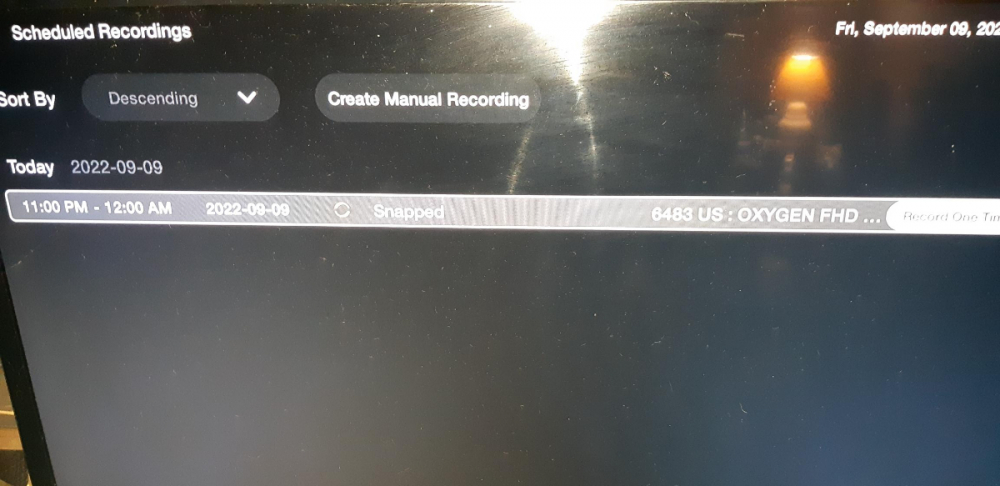

allaboutbuzz Posted September 9, 2022 Share Posted September 9, 2022 27 minutes ago, Terry Knapper said: So , if I am recording a show, say, Fri from 11PM until 12 midnight, and I want to extend the recording by 5 min then I have to set up a 2nd scheduled recording from Fri at mid until the following Sat at 5 min after midnight. Does that sound about right? How did you setup this recording? Manual Scheduling or through the EPG? If Manual, just setup the Start and End Times yourself If through EPG 2 ways 1. Press Menu PVR PVR Options Extra Recording Time, set how many minutes you want all recordings to make to have time added to the end time. 2. Press Menu PVR Scheduled Recordings Highlight the Recording you want to edit Press the yellow button to edit it You can change the end time on here and save it. 1 Quote Link to comment Share on other sites More sharing options...
Terry Knapper Posted September 9, 2022 Author Share Posted September 9, 2022 You are right. Actually you HAVE to change the end time if the end time is 0000; you HAVE to either add or subtract time, the scheduled recording will not allow a time of 0000. As far as adding time to all recordings, say 5 min, I have run into problems recording two shows, one after the other. I almost always start my scheduled recording(s) from the EPG, then edit it in the scheduled section. Quote Link to comment Share on other sites More sharing options...
dishuser Posted September 9, 2022 Share Posted September 9, 2022 (edited) 27 minutes ago, Terry Knapper said: You are right. Actually you HAVE to change the end time if the end time is 0000; you HAVE to either add or subtract time, the scheduled recording will not allow a time of 0000. As far as adding time to all recordings, say 5 min, I have run into problems recording two shows, one after the other. I almost always start my scheduled recording(s) from the EPG, then edit it in the scheduled section. it allows that time if you change the date like I said earlier if you do it from epg it shows 12:00 am and next day Edited September 9, 2022 by dishuser Quote Link to comment Share on other sites More sharing options...
Terry Knapper Posted September 9, 2022 Author Share Posted September 9, 2022 From a pre scheduled recording say Friday, as I see it, you do not have the choice to start the recording on Fri and end it on Sat. You only have one day to play with. I have found out , on paper, you can add to the 0000 time to give you more recording. I haven't tried that yet. Quote Link to comment Share on other sites More sharing options...
dishuser Posted September 9, 2022 Share Posted September 9, 2022 manual plus from epg notice the times/dates 1 Quote Link to comment Share on other sites More sharing options...
