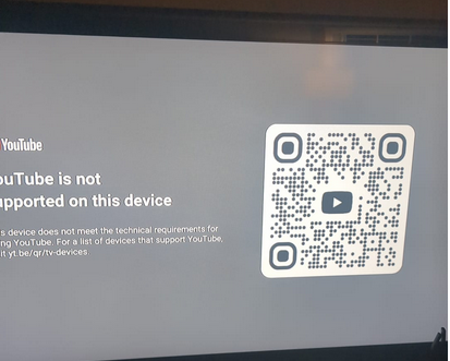

However, when he tried to launch youtube, he got the same message another user was getting on his B5 recently.
Youtube is not supported on this device.

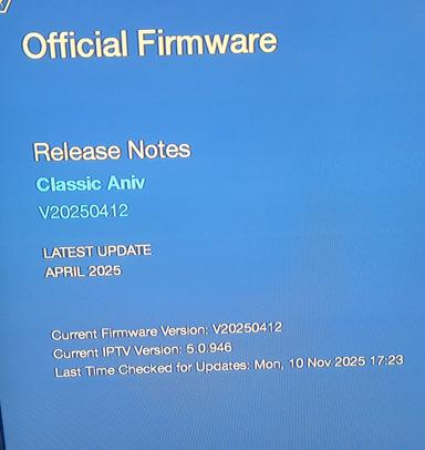

Asked him to check the firmware and software version running on his box, and he has V20250412 with 5.0.946 (not that this portion makes a diff for this case):

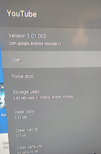

And for Youtube version, he has 3.01.005 (which happens to be the same as on my mom's B5 I checked this weekend):
Even though my mom's B5 has the same version and works well, I also checked my original Buzz Classic at home and I have youtube (com.google.android.youtube.tv) version  5.30.304 on my original Classic.

Same here on my latest purchase of buzz boxes (classic anniversary edition)

It is not possible to Uninstall the YouTube app , there is no un install option on the affected devices.  You also cannot revert updates.
there are no options but to Force Stop and Clear Data/Cache.

On Aptoide, the one you want is not just "Youtube" (from Google Inc), that one is more for phones.  The one you want is labeled as "Youtube for Android TV", and the versions all match, and you should have the option to "update" not "install".    Since the internal name will match the com.google.youtube.android.tv as shown above.
I don't have the anniversary edition to test, but check it out and let us know.
And yes Aptoide has piles of apps, you just need to ensure the publisher matches what you are looking for or you could end up with all sorts of apps that are not what you thought they were.
