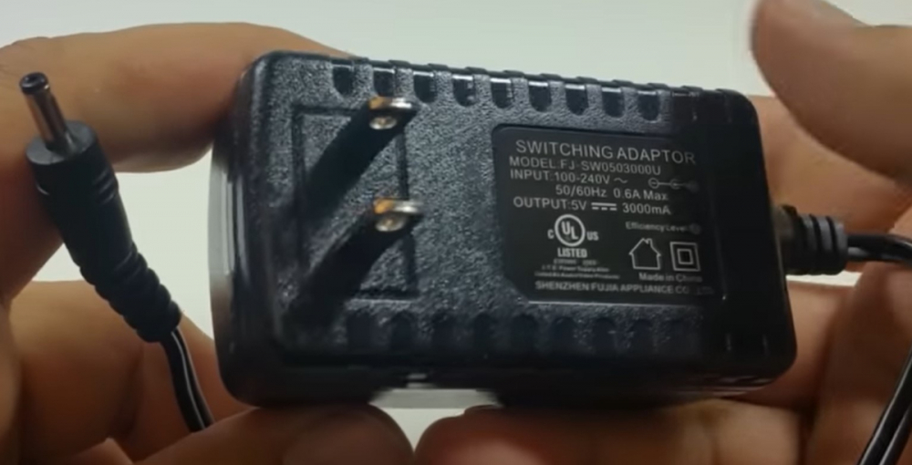

Emporium Posted December 19, 2022 Share Posted December 19, 2022 (edited) 49 minutes ago, dishuser said: but I forgot one important fact the 3900 uses a 12v adapter Are you sure ? I thought only the xrs4900 and U5 used 12V adapters, due to the SATA HDD port. According to an old unboxing Video, it says 5V, 3A... https://youtu.be/J-1VYkcPMgE?t=52 And a closeup still shot from the video: Edited December 19, 2022 by Emporium Quote Link to comment Share on other sites More sharing options...
dishuser Posted December 19, 2022 Share Posted December 19, 2022 not positive but I do know my ps doesn't look like that mine has print on side not bottom left my bifocals at work so can't check until tomorrow afternoon and a 3000 ps is 1.5 amperage Quote Link to comment Share on other sites More sharing options...

Emporium Posted December 19, 2022 Share Posted December 19, 2022 OK.. So it is confirmed that it is a 12V 3A power supply on the 3900. You may be able to get away with a 2A version if you don't use the internal HDD slot, or if you are using an SSD... but it you have a regular mechanical 2.5" HDD, I am pretty sure you will need the 3A, since the 2A would probably be just shy of having enough power with an HDD present. 1 Quote Link to comment Share on other sites More sharing options...
