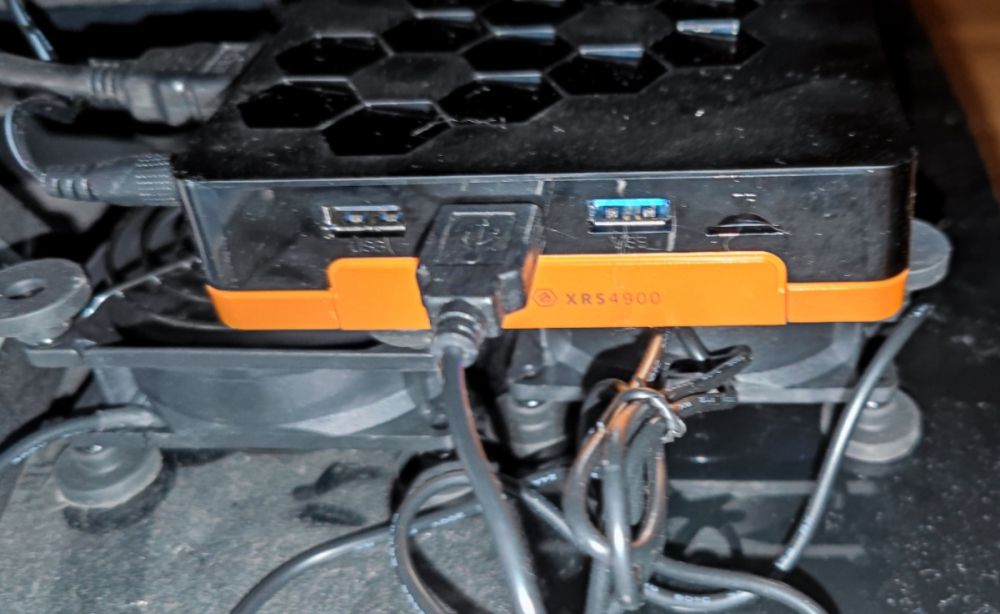

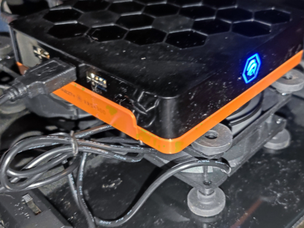

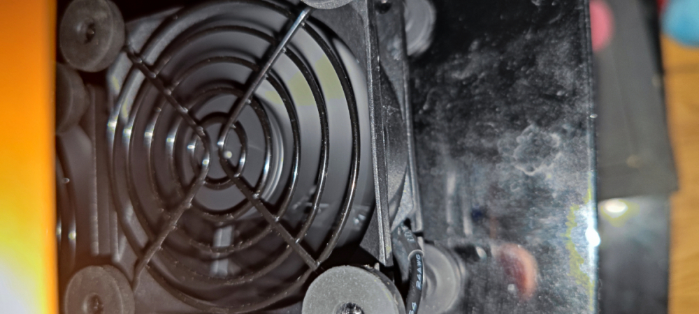

semsem Posted June 28, 2022 Author Share Posted June 28, 2022 I figured out a fix without changing my drive. $15 makes the box cool Better performance. On 6/25/2022 at 10:01 PM, dishuser said: did you install a drive in the bottom? 1 Quote Link to comment Share on other sites More sharing options...

BUZZ_GUY Posted August 20, 2022 Share Posted August 20, 2022 Is your XRS 4900 is an open area and elevated off of a flat surface? If not, I purchased a 4'x4' usb fan that plugs into my unit. Check Amazon. Quote Link to comment Share on other sites More sharing options...
