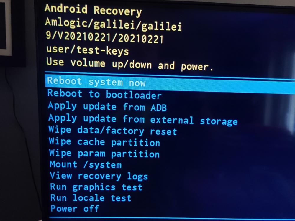

Androidforsure Posted February 28, 2021 Share Posted February 28, 2021 Has anyone had connection issues with ethernet connection? Just got my box and cannot get over 10 mbps on the gigabit lan. My provider is 1 gigabit. I also had issues connecting my wireless. It found my name but would not connect to it. It said no connection with that name. I then disconnected the Lan cable and the wireless connection worked fine with 450 mbps speed. I tried plugging the Lan cable back in and lost my wireless. Very strange!! And to top it off, I turned my box on this morning to get a recovery screen popup. Cannot do anything with my 4900 now. Quote Link to comment Share on other sites More sharing options...
dishuser Posted February 28, 2021 Share Posted February 28, 2021 select wipe data/factory reset Quote Link to comment Share on other sites More sharing options...
Androidforsure Posted February 28, 2021 Author Share Posted February 28, 2021 Tried that....keeps coming back to the Recovery screen or freezing up Quote Link to comment Share on other sites More sharing options...

Ed B Posted March 3, 2021 Share Posted March 3, 2021 On 2/28/2021 at 3:06 PM, Androidforsure said: Has anyone had connection issues with ethernet connection? Just got my box and cannot get over 10 mbps on the gigabit lan. My provider is 1 gigabit. I also had issues connecting my wireless. It found my name but would not connect to it. It said no connection with that name. I then disconnected the Lan cable and the wireless connection worked fine with 450 mbps speed. I tried plugging the Lan cable back in and lost my wireless. Very strange!! And to top it off, I turned my box on this morning to get a recovery screen popup. Cannot do anything with my 4900 now. I'm stuck in the same recovery screen loop and I don't know how to get out of it. I just finished setting up my new XRS4900 and in configuration menu I selected backup config to USB drive. That sounded like a good idea, who doesn't want backups after setting everything up just right and adding accounts, etc. Now I'm stuck and the box will only boot to Android recovery FML. If anyone knows how to escape this predicament, I'd be very happy to hear!It's the exact same screen as in the OP's picture. Please note, I was not experiencing any problems with Ethernet or connectivity, I was merely finishing up the setup of a new box. Quote Link to comment Share on other sites More sharing options...

Juanita32022 Posted March 3, 2021 Share Posted March 3, 2021 Solution is "EXTERNAL RECOVERY" file sent me yesterday by BUZZTV for my XRS4900. Quote Link to comment Share on other sites More sharing options...
Ed B Posted March 3, 2021 Share Posted March 3, 2021 I did hear back quickly from support and I downloaded the recovery file and did the External Recovery. It's up and running now, except after the update the ethernet is not working anymore Quote Link to comment Share on other sites More sharing options...

buzywoman Posted March 4, 2021 Share Posted March 4, 2021 I am same issue using backup function and after stuck in amlogic recovery, probably update zip fix problem ? Quote Link to comment Share on other sites More sharing options...
