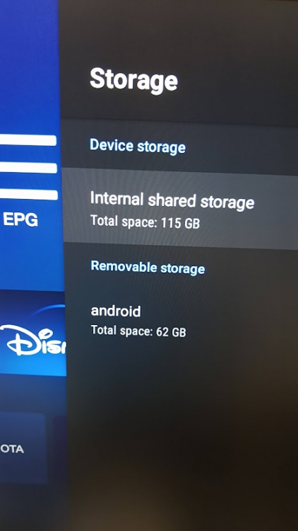

Emporium Posted January 9, 2023 Share Posted January 9, 2023 When you say "would not be able to use the drive outside of the X5 128 AX" that would not be correct, since that would be formatting it as internal storage, where the Android OS is "adopting" the filesystem. This can cause an issue since if it is formatted using that method, then there is a possibility that when you install applications, it would go to that drive (since it assumes it is part of the internal storage). If you have a decent quality USB key, you can even format it on a PC if you please. However on a PC in order to get the most out of the key with no limitations, change the file system type to "exFAT". Not FAT32 or NTFS. FAT32 has a 2GB file size limitation. For small recording or downloads it is not a problem. But if you want to download large movies, this will be an issue. When you go to Settings -> Device Preferences -> Storage. What do you see ? OK, on top you have Device Storage, and it should list Internal Shared storage, and it should say "Total space: 115GB". Then if it is done correctly, you should see Removable storage, with the name of the USB key underneath it, and then Total Space: xxGB where xx is the size of the key (similar to image I attached). Also, make sure you are using the correct port. I am assuming the X5 AX Special edition is similar to the X5 (non SE), as it has 2 USB ports on the side. One is a USB 2.0 one (black internal connector), and the other one is a USB 3.0 (Blue internal connector). Ideally your key is a USB3 key, and to take advantage of it's full speed, you should insert it into the one with the Blue connector. Quote Link to comment Share on other sites More sharing options...
