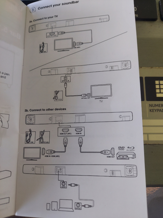

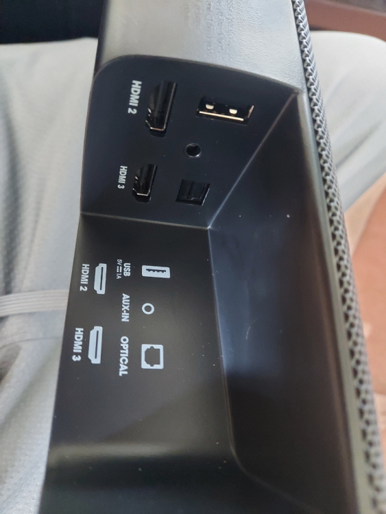

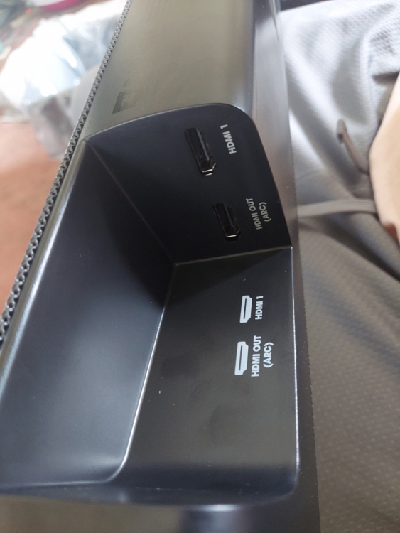

Hi folks. I am adding an addition to my X5 system. I am adding a 5.1 surround bar. I have attached pics, so the community can see the hookups. I am requesting help on how to hook this up the X5, soundbar and Vizio TV together.
Thanks!
I would take HDMI from box to surround bar then HDMI out from surround bar  to tv. then I would also take optical cable from box to surround bar.

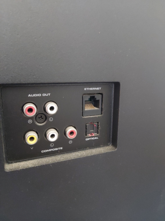

for my parent I ran HDMI cables from 3 devices to tv then optical cable from tv to surround bar. I change audio settings to optical in my tv so this way no matter what they play it plays on surround bar without touching another remote or changing settings. 🙂

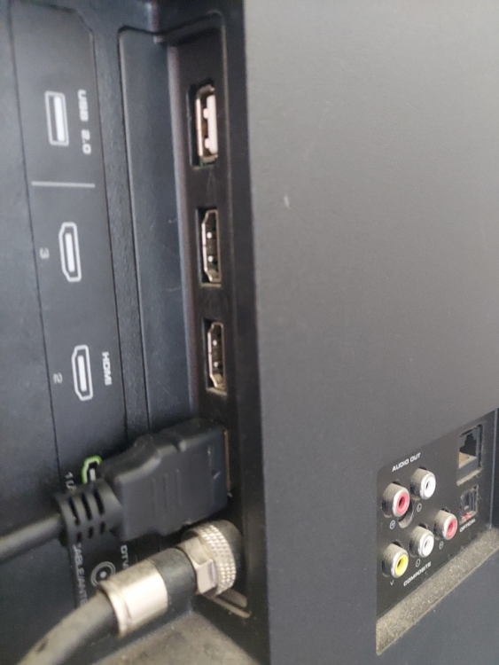

Nice tips RYU. I however have it set up a little different now anyway. I came out of the x5 to the HDMI on the TV. Then out of the TV back to the soundbar. It works! Not sure that I know if it is the best way or not. x5 remote controls the volume. You say keep volume to zero. What device are you talking about?
