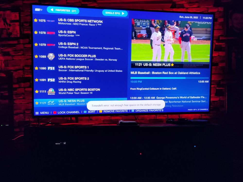

Mark M Posted June 6, 2022 Posted June 6, 2022 Every time I change stations using the BuzzTV 5 app I get this message : Timeshift error: not enough storage space on the default storage. I have the 128GB model, which has 115 GB free, so storage space shouldn't be an issue. What's up with this, and how do I make this warning go away? Thanks! 1 Quote

allaboutbuzz Posted June 6, 2022 Posted June 6, 2022 3 minutes ago, Mark M said: I didn't say you did...I was asking. Timeshift is on, and storage location is internal shared storage, which has 115GB free space Using Internal Storage for timeshift is a bug on Android actually It requires a lot of space to use it. We will be removing it as an option in a future update If you want to use Timeshift its best to use a USB or SD Card. 1 Quote
