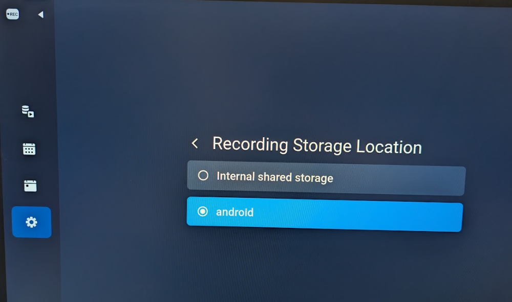

Macman_ca Posted March 13 Posted March 13 I tried to do a recording last night on BuzzTv Powerstation 6 Unlimited and it kept failing. It couldn't see the internal storage or my WD NVME 2TB. I tried rebooting, I tried unseating the NVME no luck. The TV menu was also acting slow to go sideways. Any thoughts? Quote

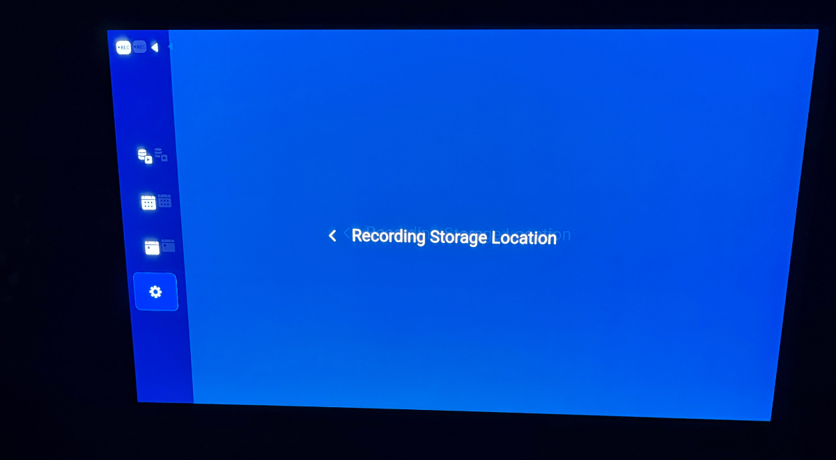

Macman_ca Posted March 13 Author Posted March 13 it won't let me change where to record to. it freezes when I go to select storage. It isnt seeing the internal storage. I have to go back to main menu/guide. It is locking up for any recordings. Seems to be the box?? Quote

Emporium Posted March 13 Posted March 13 (edited) Definitely odd. I just checked and I have internal showing and "android" which is a small 250GB NVMe I have installed in it. And if you go to Settings->device Preferences->Storage you don't see the "Removable storage" ? HAVE YOU UNPLUGGED the POWER for 10 seconds on the box, instead of just power off/power on ? Edited March 13 by Emporium 1 Quote

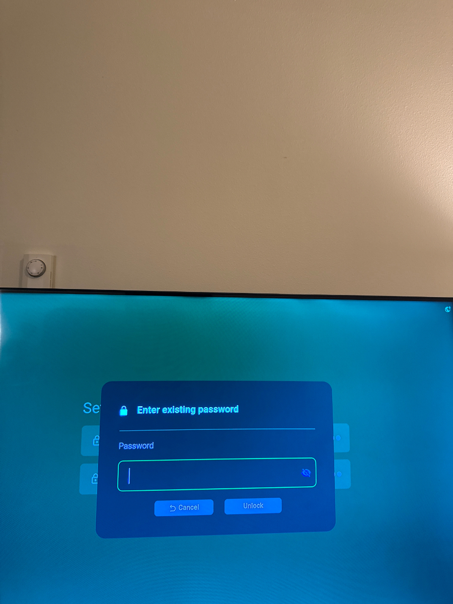

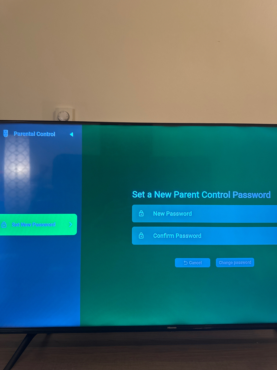

อาทิตย์ สมสาร์ Posted March 25 Posted March 25 Hello, can anyone please advise me about I can't decrypt the password. Quote
