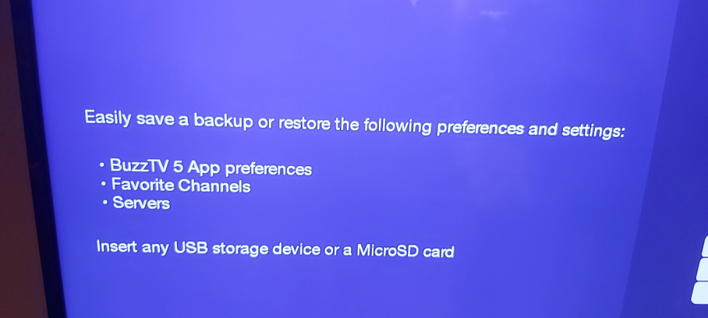

trupillo Posted June 19, 2024 Author Posted June 19, 2024 So I did the factory reset and also de hard reset. Th problem persists. When I record from the EPG it works fine but if I schedule the recording and it covers more than one EPG entry, it will only record 30 minutes. The recordings also have problems sometimes as I cannot FF. I saw some other posts that talk about similar problems. TS an PVR definitely have problems! I hope BUZZTV takes notice. By the way, the BACKUP does not backup the APPS. I had KODI with full addons and had to download everything again. Quote
Emporium Posted June 19, 2024 Posted June 19, 2024 First of all, no one ever said backups would backup any 3rd party apps. They back up BuzzTV settings. Backing up 3rd party app settings, is the responsibility of the 3rd party app developers. Everyone does things differently, and Buzz is not going to guess how and what needs to be backed up, or go down that rabbit hole. Doing a machine snapshot (like they used to do on older boxes), kind of defeats the purpose of doing a factory reset, if you are just going to restore the same junk over the box. The point of a factory reset is to try to start from clean slate, without the possibility of some 3rd party app causing the issues. Now for recording not being able to FF, that is a server stream issue. Buzz just records the unaltered stream. If that stream is encoded in strange ways there are some which cannot be FF or REW (and this will also affect TS). And that will vary from channel to channel. I've tested with a few different servers and some work perfect all the time, and others even the same channel (probably different sources) will just not behave properly on playback. Trying to FF or REW will sometimes even force the stream to play from the beginning again. But that is the source stream. Have you tried to change the stream type ? From LiveTV (menu->settings->configuration and I think it is the 7th settings from the top. Also, keep the RealTime Streaming and Tunneled playback turned off for better compatibility with some servers. Forcing the stream type to TS can sometimes yield better results for recordings. 2 Quote
dishuser Posted June 19, 2024 Posted June 19, 2024 4 hours ago, nbs. said: Helps to read also read the replies here as well Emporium told them what they can back up Quote
