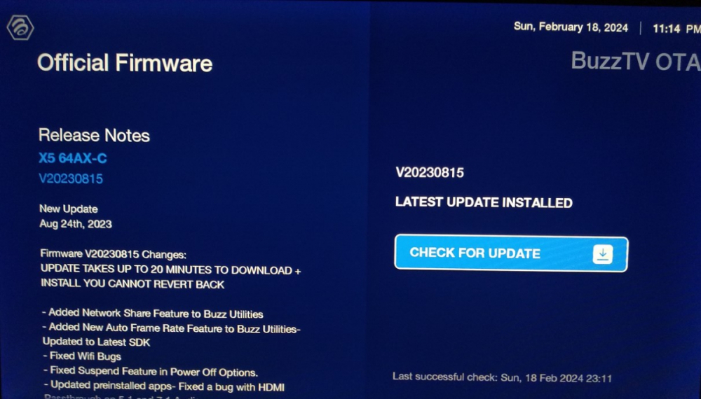

Emporium Posted February 19, 2024 Posted February 19, 2024 Can you post what version of Firmware and Software you are running ? Just to make sure you are running the latest versions, and you are not for some odd reason stuck at an older version. Software version you can easily find if you press the menu button when watching LiveTV, and it is at the bottom V5.0.xxx. Firmware you can find in the Updates screen V202xXXYY Quote
Dougie Posted February 19, 2024 Posted February 19, 2024 1 minute ago, Emporium said: Can you post what version of Firmware and Software you are running ? Just to make sure you are running the latest versions, and you are not for some odd reason stuck at an older version. Software version you can easily find if you press the menu button when watching LiveTV, and it is at the bottom V5.0.xxx. Firmware you can find in the Updates screen V202xXXYY App / software version is 5.0.919 Firmware version v20230815 Quote
dishuser Posted February 19, 2024 Posted February 19, 2024 5 minutes ago, Emporium said: Can you post what version of Firmware and Software you are running ? Just to make sure you are running the latest versions, and you are not for some odd reason stuck at an older version. Software version you can easily find if you press the menu button when watching LiveTV, and it is at the bottom V5.0.xxx. Firmware you can find in the Updates screen V202xXXYY both software and firmware versions can be found in updates Quote
Emporium Posted February 19, 2024 Posted February 19, 2024 27 minutes ago, dishuser said: both software and firmware versions can be found in updates Typically (and in most cases) yes.. Unfortunately, not always on the main updates page. Which is why I typically say to check the bottom of the menu. Example on my X5 AX-C.. The release notes of the last firmware update, take up most of the area (I like to see release notes), you'd have to go and then scroll down (and I honestly didn't check if it says it further down - I assume it does).. Quote
