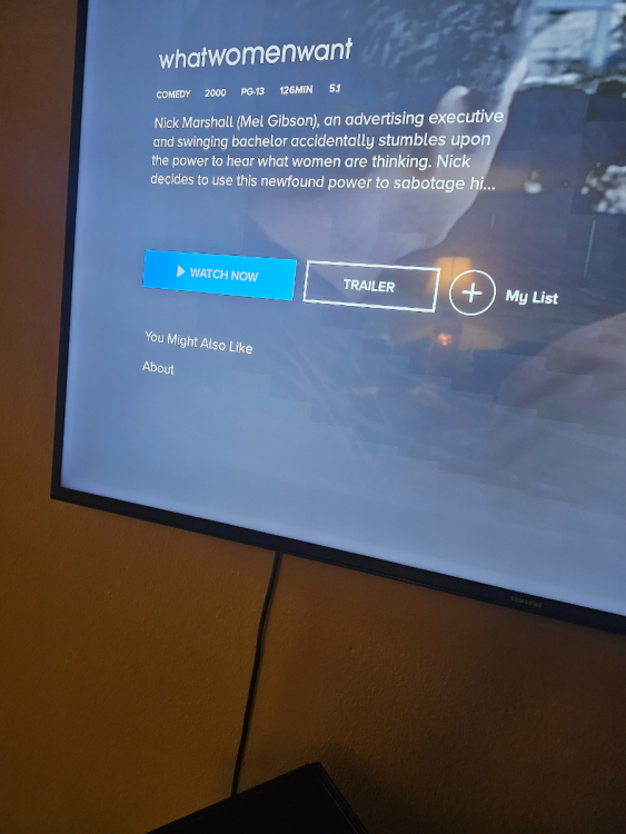

Chris1 Posted May 16, 2023 Posted May 16, 2023 I was wondering how to get parmount plus to do 5.1 because It saying 5.1 on the app but doesn't give me the option to do 5.1Â Quote
