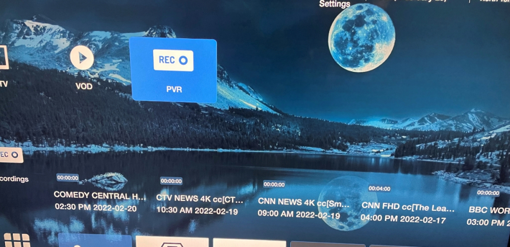

steelerzz Posted February 20, 2022 Posted February 20, 2022 hope someone can help with what I'm doing wrong! All my PVR Recordings are showing on my front page with picture and details but recording times are all 00:00:00 in duration. I've tried recording to both the internal shared storage, and a SanDisk USB drive, and get same result. I have been unable to record anything at all since the Buzz5beta update on my Buzz 4500XRS Any suggestions? Quote
steelerzz Posted February 20, 2022 Author Posted February 20, 2022 in the EPG view, I find the program wishing to record, select the enter button in remote and then choose the red "Set Recording" option from the three menu options. Quote
