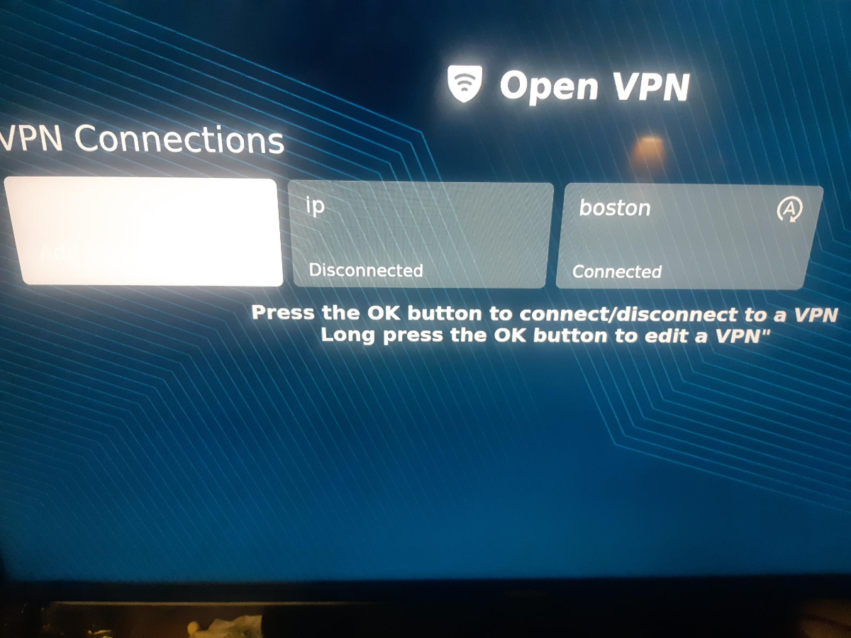

AllBlaxx Posted May 19 Posted May 19 I don't seem to be able to crack this. Loaded the config file on to a stick to import on the box, enter my credentials and it just goes back to the VPN Connections screen. If I turn off "Use Credentials" and try to connect, I get an error message that says Not connected to VPN. Quote
dishuser Posted May 19 Posted May 19 you don't load the whole config at once you load a server location one at a time I spent more time editing config than loading it Quote
Emporium Posted May 19 Posted May 19 I don't know if it has been fixed, but there was a UI issue, hat even if you load config, sometimes it doesn't show until after a reboot. I had played with 4 or 5 server config files and I had issue with them. After reboot, all the configs showed up and the ones that didn't work before, ended up working. I did have 2 or 3 configs that didn't and I need to run more tests (and provide the details), but after importing configs, try a reboot (either way, reboot on this box is like 10 seconds ) Quote
dishuser Posted May 19 Posted May 19 16 minutes ago, dishuser said: you don't load the whole config at once you load a server location one at a time I spent more time editing config than loading it so you can see what I'm saying Quote
dishuser Posted May 20 Posted May 20 are you selecting add vpn and the selecting file? then picking a server location and naming it and save? Quote
allaboutbuzz Posted May 20 Posted May 20 Emporium made me aware of some VPN bugs, like the ones mentioned above They will be fixed in our next update. 1 Quote
