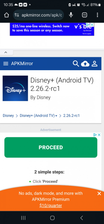

Chris1 Posted December 10, 2023 Author Posted December 10, 2023 I use the one that was posted a while ago that you need to download Quote
Chris1 Posted December 10, 2023 Author Posted December 10, 2023 Should i try this i see it come out 9 days ago Quote
