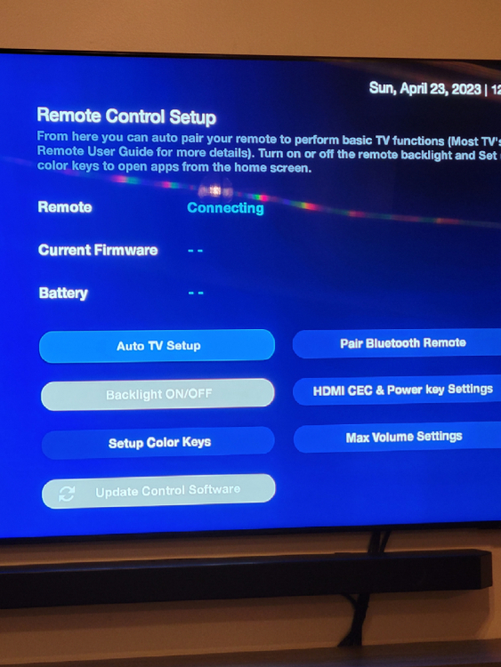

Emporium Posted April 23, 2023 Share Posted April 23, 2023 42 minutes ago, Redhusker24 said: I can use it and move it around like normal but in the remote app it says remote connecting and the blacklight option is greyed out. That usually means it is NOT paired with BT. You are probably just using the IR functions of the remote. Manual can be found here: https://buzztv.com/site/wp-content/uploads/2022/05/BT400-300_manual_WEB_v6_Compress.pdf I'd probably go into remote/accessory menu, unpair the remote, then do a factory reset on the remote (see manual above), and then go into menu and add new remote and put remote into pairing mode to re-pair the unit. Quote Link to comment Share on other sites More sharing options...

Redhusker24 Posted April 23, 2023 Author Share Posted April 23, 2023 How do I pair it again? Quote Link to comment Share on other sites More sharing options...
dishuser Posted April 23, 2023 Share Posted April 23, 2023 26 minutes ago, Redhusker24 said: How do I pair it again? are you trying to be funny? you were given a link you were told about the start smart card it gives you this link https://buzztv.com/site/smart-remote/ Quote Link to comment Share on other sites More sharing options...
Redhusker24 Posted April 23, 2023 Author Share Posted April 23, 2023 It works but it won't let me select the backlight option and when I go into remote settings it also says connecting still. Quote Link to comment Share on other sites More sharing options...
dishuser Posted April 23, 2023 Share Posted April 23, 2023 46 minutes ago, Redhusker24 said: It works but it won't let me select the backlight option and when I go into remote settings it also says connecting still. are you still referring to the bt 400? you're all over the place in this thread Quote Link to comment Share on other sites More sharing options...
Redhusker24 Posted April 23, 2023 Author Share Posted April 23, 2023 Sorry yes the BT400 Quote Link to comment Share on other sites More sharing options...
dishuser Posted April 23, 2023 Share Posted April 23, 2023 home screen/all apps do you see buzztv smart remote app? Quote Link to comment Share on other sites More sharing options...
Redhusker24 Posted April 23, 2023 Author Share Posted April 23, 2023 Quote Link to comment Share on other sites More sharing options...
Redhusker24 Posted April 23, 2023 Author Share Posted April 23, 2023 That's all it says and yes it's installed Quote Link to comment Share on other sites More sharing options...
Emporium Posted April 23, 2023 Share Posted April 23, 2023 CHANGE batteries... When batteries are getting low, the IR functions will continue to work and BT functions will take a back seat. Quote Link to comment Share on other sites More sharing options...
dishuser Posted April 23, 2023 Share Posted April 23, 2023 did you press home/ok buttons at same time to scan for remote? and get within a few feet of the box? Quote Link to comment Share on other sites More sharing options...
