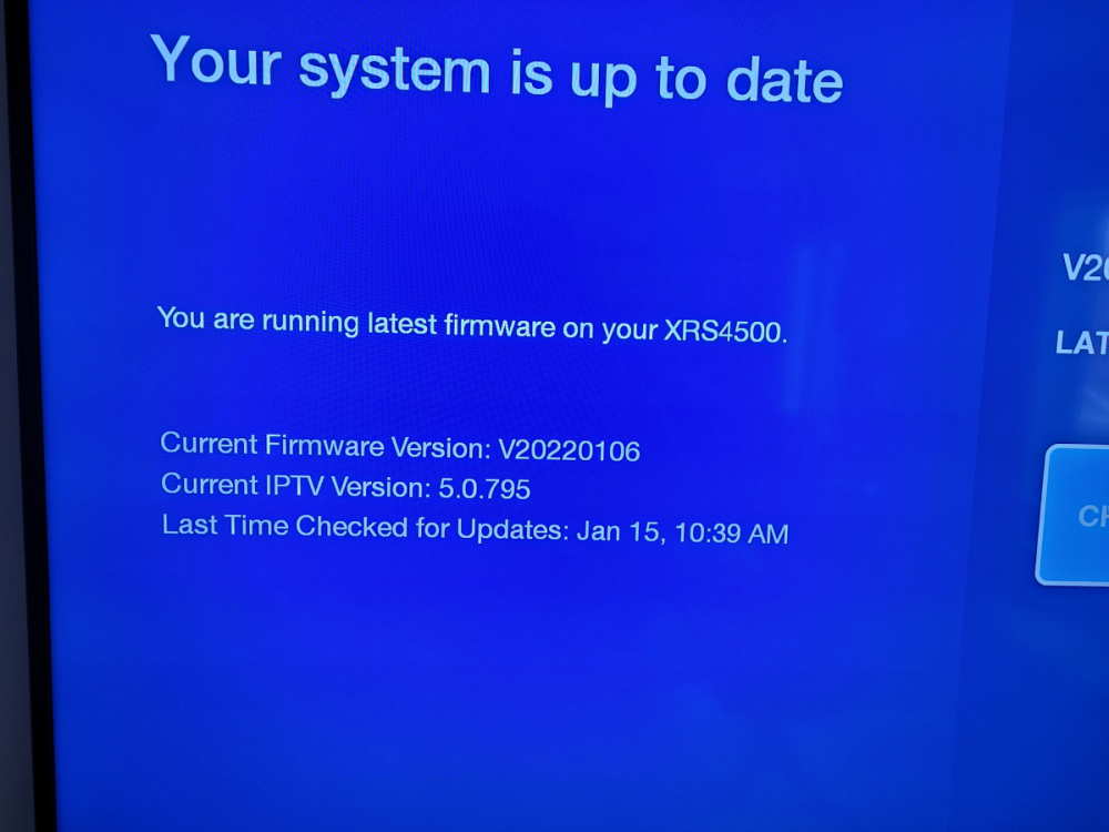

We have XRS4500 and it will not record / pvr properly.
We have firmware V20220106, IPTV version 5.0.795. it was last updated January 14, 2023 (yesterday).
I have rebooted the modem, router and buzz box.
We have 55 GB of storage available
