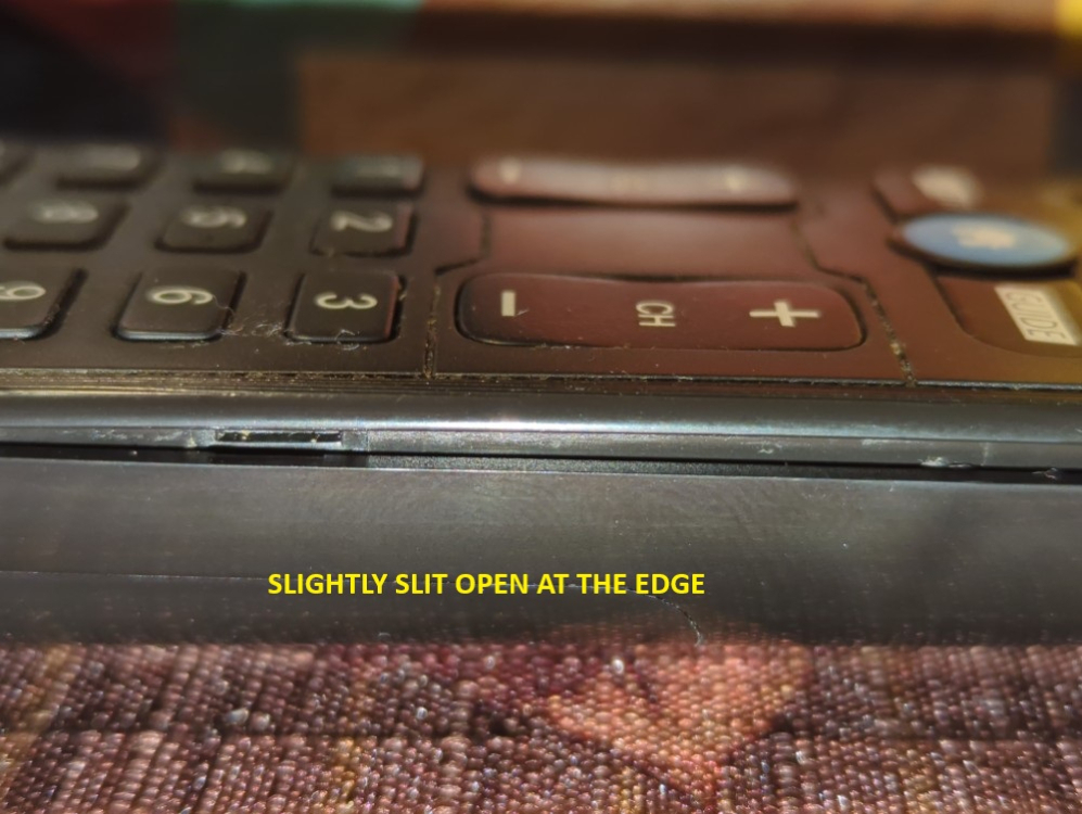

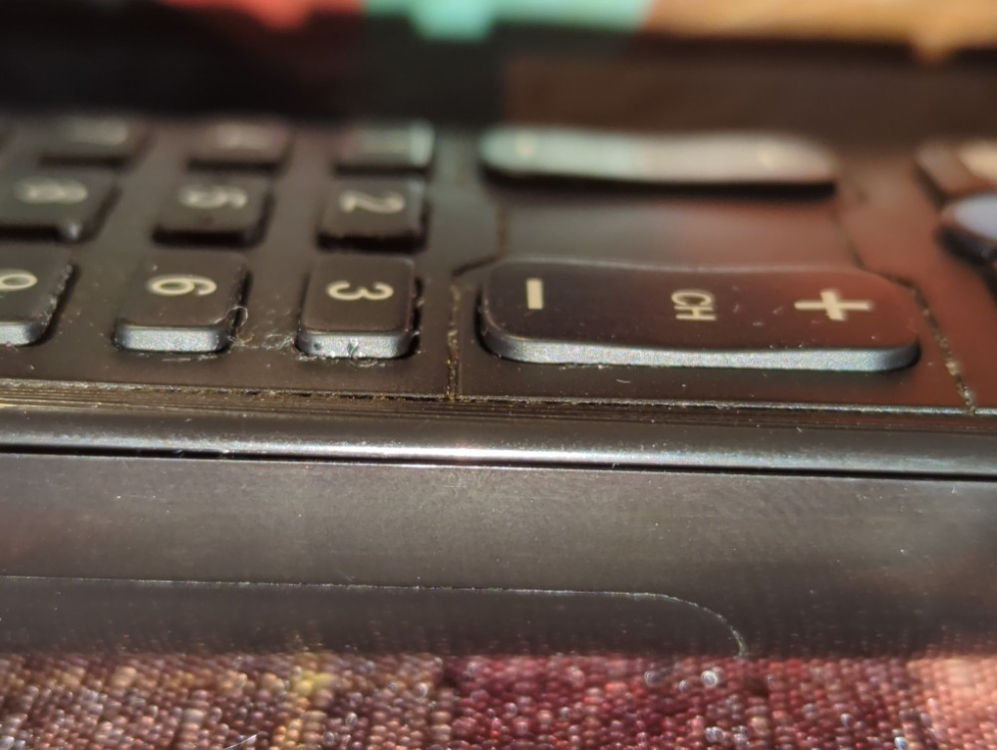

Emporium Posted September 22, 2025 Posted September 22, 2025 Have you read my suggestion in the 2nd post from the top ? Change your power option to "shutdown" instead of suspend. For the remote, I assume you tried replacing batteries with a fresh set ? It unfortunately all depends on how you treat the remote. If it drops a couple of time, or used with wet hands, it can tend to deteriorate pretty quick. Have you checked to see that the remote has not split open along the sides ? When it falls (since mine do occasionally fall), the remote tends to split open on one side (clips let go a bit). Squeezing it shut again, and snapping back into place, tends to fix the issue. Quote

Emporium Posted September 22, 2025 Posted September 22, 2025 (edited) 1 hour ago, slowMoe said: Yeah I did your first suggestion. That took care of that issue but then this arose. Lol BuzzTV remotes do NOT use coin cells. Every buzztv remote I know uses AAA batteries (IR50, IR100, IR200, BT100, BT200, BT250, BT350, BT400, G20) and even the ARQ series. And very simple to replace by just sliding back cover off. And you say "this issue arose", yet this is your first post to this thread ? What issue ? Do you have 2 accounts (SlowMoe and jawjahpeach) ? Edited September 22, 2025 by Emporium 1 Quote
jawjahpeach Posted September 23, 2025 Posted September 23, 2025 4 hours ago, Emporium said: Have you read my suggestion in the 2nd post from the top ? Change your power option to "shutdown" instead of suspend. For the remote, I assume you tried replacing batteries with a fresh set ? It unfortunately all depends on how you treat the remote. If it drops a couple of time, or used with wet hands, it can tend to deteriorate pretty quick. Have you checked to see that the remote has not split open along the sides ? When it falls (since mine do occasionally fall), the remote tends to split open on one side (clips let go a bit). Squeezing it shut again, and snapping back into place, tends to fix the issue. Power option is already set to shutdown Yes, batteries have been replaced. Remote has never been dropped, never fallen or been handled with wet hands. Nothing has ever been spilled on it. It is intact. 1 Quote

Emporium Posted September 23, 2025 Posted September 23, 2025 Try unpairing it and see if in IR mode it is responsive. If it is responsive in IR mode (obviously you need to point the remote in the general direction of the box), then maybe there is an issue with interference with the bluetooth. Is the box located next to any other wireless devices (Router, cordless phone, etc..), or even some motor load (like a portable AC or something) ? If TV has wifi on it, try just as a test, to disable the WiFi on the TV. For the remote, when I mentioned earlier about dropping it, it is not always a drop. Sometimes it can happen if for some reason someone sits on it, or rolls over on it (plenty of mine split open on occasion if I forget them on the couch and site on them). It is very subtle if you are not looking at it from the side, so you may not notice it, but it raises the plastic ever so slightly that the buttons are no longer "raised". Anyhow, you can see the pics attached, First one is slightly split along the edge and you can see the buttons are flush because of that. The second pic, with it squeezed back together the buttons are raised, making them easier to use and more responsive. Anyhow, just something to check, since I have had 2 friends who have had that issue, and we got a good laugh when I went over and just squeezed the remote back together. 1 Quote
jawjahpeach Posted October 27, 2025 Posted October 27, 2025 There are no other devices near it, in the same room or even in adjoining rooms. I disable wifi on the device on occasion to refresh the connection. The problem is that the box also turns off wifi on its own. While watching a program, I will lose connection then find that wifi has been turned off. It was turned on when I started watching. Cover is intact. It has never been sat on, rolled over on, dropped, had anything spilled on it. Quote
